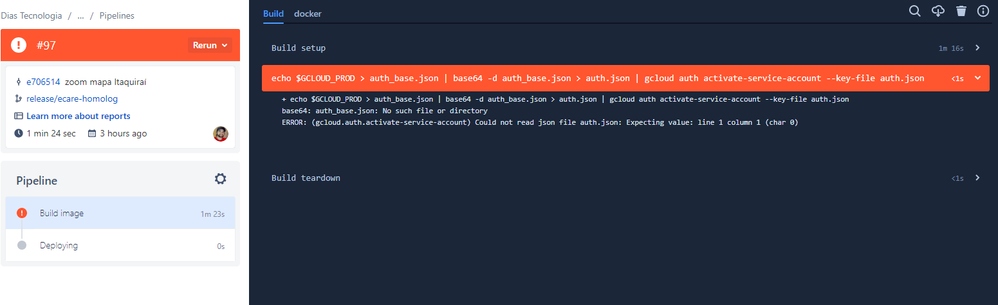

I'm having a problem when executing automatic pipelines (from a commit in a branch) with this code block below.
echo $GCLOUD_PROD > auth_base.json | base64 -d auth_base.json > auth.json | gcloud auth activate-service-account --key-file auth.json
 It always fails. When a manually start it from GUI it works.

It´s working (when started manually) in a bunch of projects. See the attached image.
That's because de subsequent commands do not need the stdout and/or stderr.
They are working with the file created.
I divided it into two files only to make more clear the process.
First, get the base64 env and create a file, after convert that base64 file to a plain text file.
And, so then, log into gcp.

- echo $GCLOUD_PROD > auth_base.json | base64 -d auth_base.json > auth.json | gcloud auth activate-service-account --key-file auth.json

base64 is throwing the error, not finding file.  So my mind goes to the previous command, echo.  Echo's simplicity has me wondering about the variable.
I personally would either debug locally or try to isolate cause with lots of debug statements to isolate cause.
  • break each command to their own line, getting their own error
  • download the full log, sometime snot all message show in UI
  • add debug commands like "echo $GCLOUD_PROD" without redirect (ensure variable is set to secure in repo settings to mask it.
  • add ls command after echo to make sure it was written.
