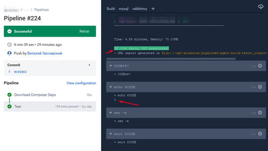

Looks similar, but in first case I have this output:
+ set +e
+ ./vendor/bin/codecept run unit,integration,functional --skip-group images --xml test-reports/report.xml
Codeception PHP Testing Framework v2.4.2
Powered by PHPUnit 7.1.5 by Sebastian Bergmann and contributors.
# skipped useless data
Time: 4.59 minutes, Memory: 70.00MB
OK (154 tests, 580 assertions)
- XML report generated in file:///opt/atlassian/pipelines/agent/build/tests/_output/test-reports/report.xml
+ CODE=$?
+ echo $CODE
0
+ set -e
+ exit $CODE

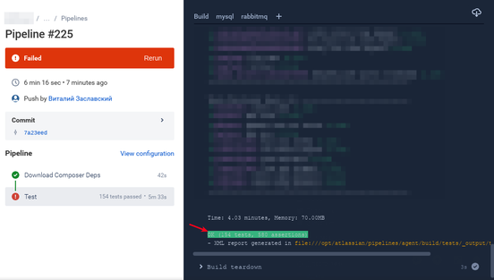

And Successful result:
And second case output:
Time: 4.03 minutes, Memory: 70.00MB
- XML report generated in file:///opt/atlassian/pipelines/agent/build/tests/_output/test-reports/report.xml[39
And for unexplained reasons it FAILS!
I don't understand what's going on and why this happens. Is someone can explain me what I do wrong, why pipeline fails even if status code is 0 and all tests pass and how can I fix it? I'll be very grateful for help..
