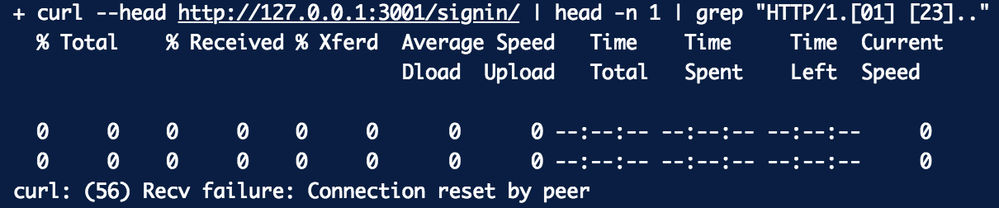

I also tried to execute the curl command directly in the pipeline shell but then I also have an error, but a different one:
Bildschirmfoto 2018-01-19 um 11.19.29.pngcurl --head http://127.0.0.1:3001/signin/ | head -n 1 | grep "HTTP/1.[01] [23].." % Total % Received % Xferd Average Speed Time Time Time Current Dload Upload Total Spent Left Speed 0 0 0 0 0 0 0 0 --:--:-- --:--:-- --:--:-- 0 0 0 0 0 0 0 0 0 --:--:-- --:--:-- --:--:-- 0curl: (56) Recv failure: Connection reset by peer
Maybe someone of you have an idea how to solve that issue. My bitbucket-pipelines.yml is sligthly changed for here and it's also pulling instead of building the image currently to speed up the feedback from the pipeline.
