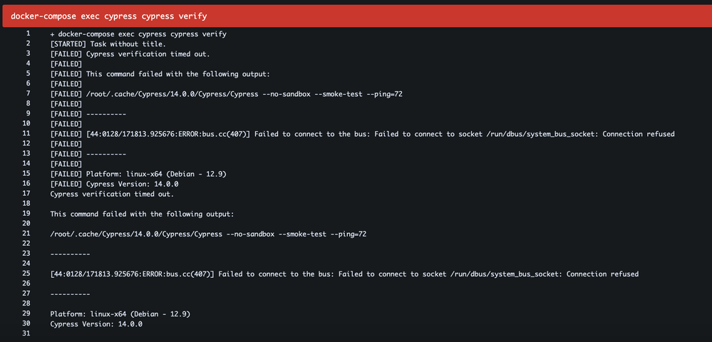

I am trying to implement regression testing using Cypress in my pipeline in one of my pipeline steps. Below screenshot is the pipeline failure where I am just simply verifying cypress
In my local, it is working fine. Seems like this issue is really related to Bitbucket pipeline itself

How can I bypass the error on the first screenshot? I want to keep using docker-compose.yml to keep for identical purposes with my local environment

Hi @Dean Christian Armada,
Could you perhaps share the content of your bitbucket-pipelines.yml file so I can try to reproduce this and understand what is happening?
Please make sure to sanitize sensitive / private data in the file (if any) before sharing. I just want to see the commands running during the build, pipelines config options, etc.

Hello Theodora,
Below is my bitbucket-pipelines.yml

Theodora Boudale
February 4, 2025
Hi Dean Christian,
Thank you for the info.
I tried to reproduce with a step as similar as possible to your &RegressionTesting step but I haven't been able to so far. However, I am missing some information that may be key to reproducing this.
  1. What commands does your script ./starter.sh execute? I am running a simple docker-compose up --detach, but I'm not sure if you're doing something different or additional things.
  2. I see in your docker-compose.yml that you have an env_file, ./envs/.cypress. Would it be possible to have the content of that file as well?
  3. I see in your &RegressionTesting step that you have an additional Docker container, backend, where you execute commands. Does this container interact at all with with the cypress container?
Kind regards,
Theodora
