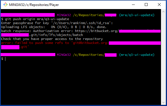

Here's the bash when I try to push the latest changes:

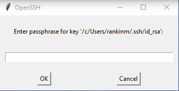

Here's the OpenSSH window that it opens multiple copies of, even when you close it.  (In the Task Manager, we can see multiple instances of it running, as "Git for Windows (32 bit)")
