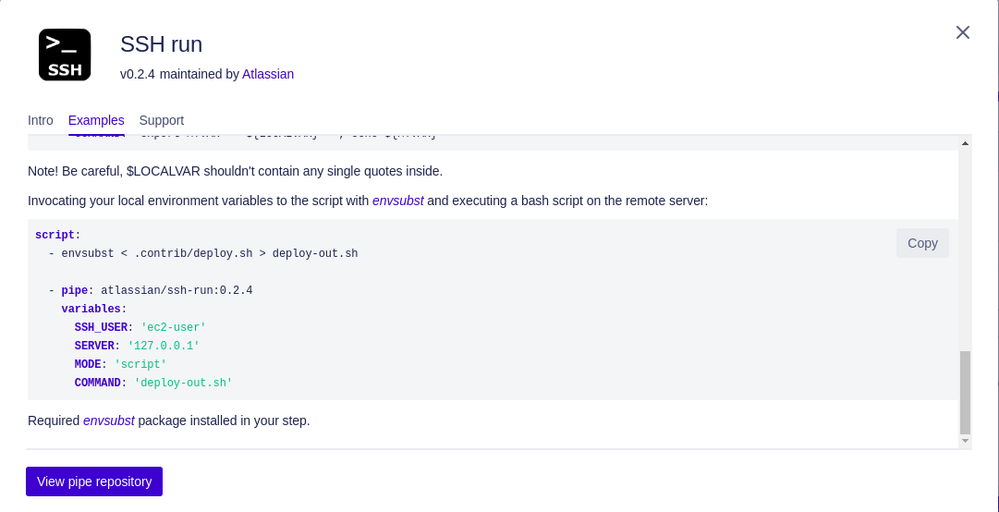

Yes, use the envsubst to replace the variables in your script(in your script with $VARIABLE) per local variables of the pipeline(out a new script with the variables replaced, $VARIABLE => Value).
Official example:
