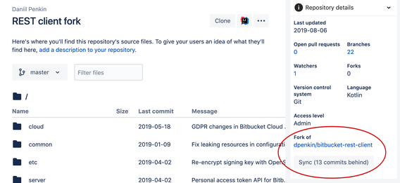

If your private repository is a fork of the reference repository, you'll see a Sync button in the right sidebar on the source view of that fork if your fork is behind:
You can also do this sync manually by first fetching from the upstream (reference repo) locally, then pushing to your fork repository in Bitbucket. You don't need to check out any branch (check out is about changing state of your working directory, not about repository itself). You can read more about working with multiple remotes in this Pro Git chapter.
Does this make sense? Let me know if you have any questions.

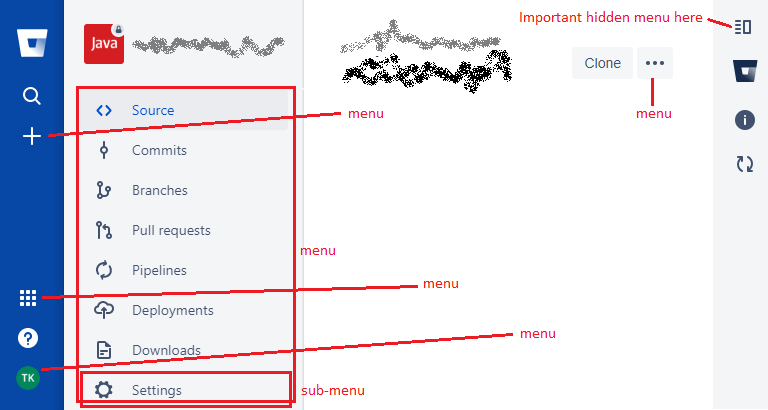

Hi @Daniil Penkin and thanks for responding,
Had to read your stuff 3 times but I got it in the end - cheers!
What I don't like about Atlassian products is that the menus are spread around too much and there is too much reliance on rather cryptic icons:
