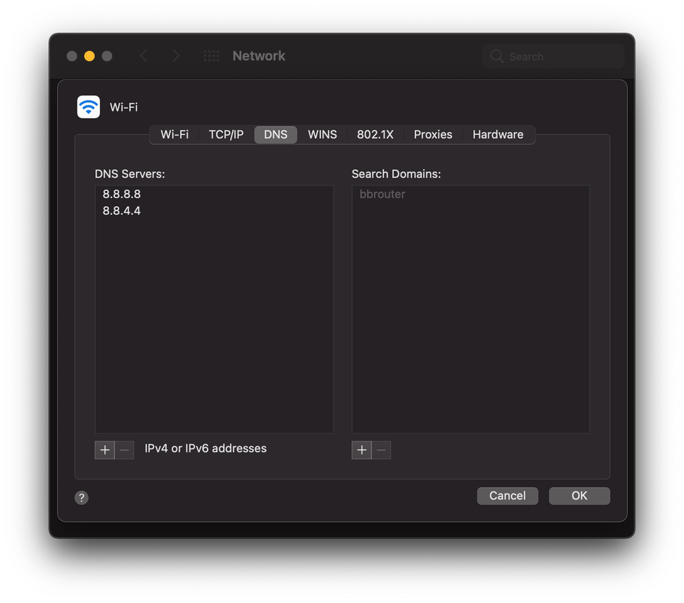

I was experiencing this exact same problem but I did not have 104.192.143.2 bitbucket.org in my /etc/hosts file.
What fixed this for me is by adding the Google DNS servers to my network settings:
Make sure to click "Apply" at the bottom of the Network settings screen after pressing OK.
