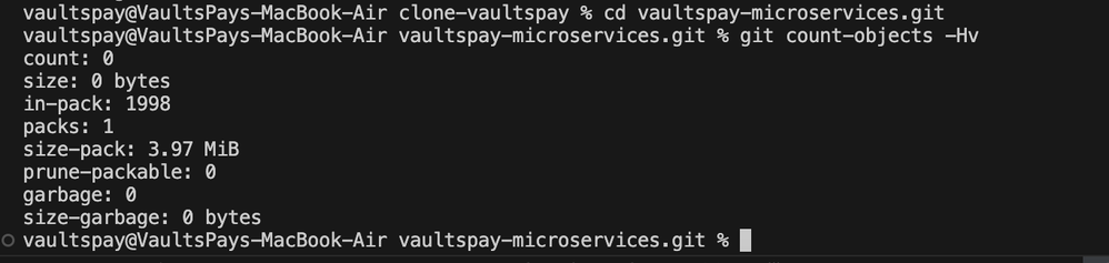

I would like to ask if you could check the following:
Take a mirror clone of the repo with the command
git clone --mirror <repo_url>
Then, navigate to the directory of the mirror clone and run
git count-objects -Hv
What is the output that you see?
If the sum of the fields size and size-pack in the output is less than 2.2 GB, then it is possible that some of the old references are still part of certain PRs in the repo.

@Theodora Boudale ok I will check that

Thank you for the info, @Ahmad Kabeer Shaukat.
Even if you deleted all branches, some refs may still exist in older PRs of the repo.
I have informed my colleague who is handling your support ticket that the size of the mirror clone is smaller, and he is going to check if it is PR refs that take up so much space.
You will receive an update from my colleague in the support ticket you created.
