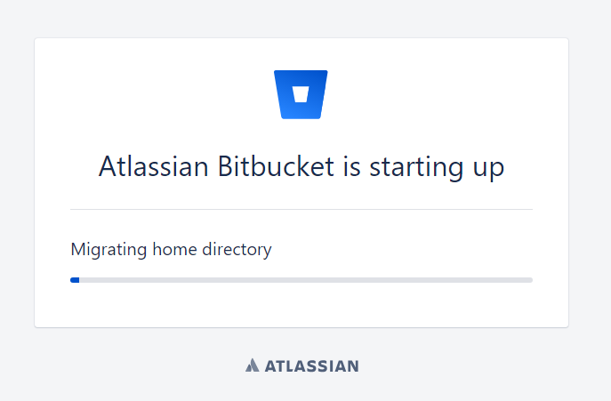

My bitbucket stuck at Atlassian Bitbucket is starting up Migrating home directory
v-natarajan
November 26, 2018

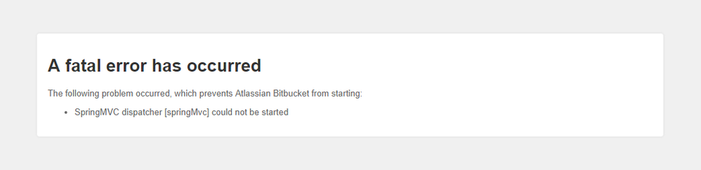

Fatal Error
SpringMVC dispatcher [springMvc] could not be started

v-natarajan
November 26, 2018
launcher.log
Java HotSpot(TM) 64-Bit Server VM warning: INFO: os::commit_memory(0x00000000e0000000, 108003328, 0) failed; error='Cannot allocate memory' (errno=12)
# There is insufficient memory for the Java Runtime Environment to continue.
# Native memory allocation (mmap) failed to map 108003328 bytes for committing reserved memory.
# An error report file with more information is saved as:
# /opt/atlassian/bitbucket/5.12.0/bin/hs_err_pid22797.log

Christian Glockner
November 27, 2018
Hi,
Looks like the machine where you're trying to run Bitbucket Server doesn't have enough memory:
