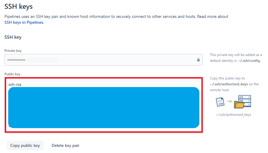

Step 1: Add an SSH key in Bitbucket

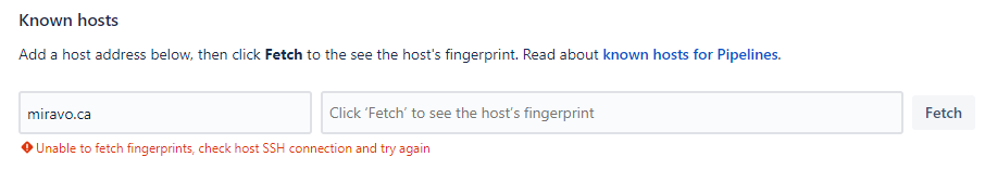

Step 2: Update the known hosts
For this step, it's not successful. I got this error message :

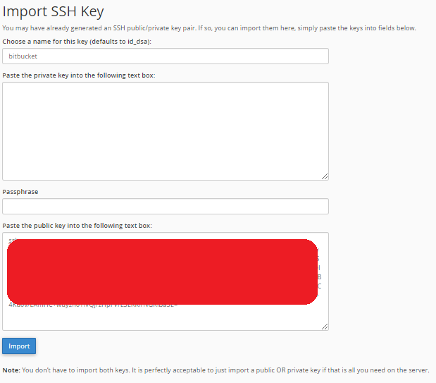

Step 3: Add the public key to a remote host
So I copied/pasted the Public key displayed in step 1 (inside the red rectangle)

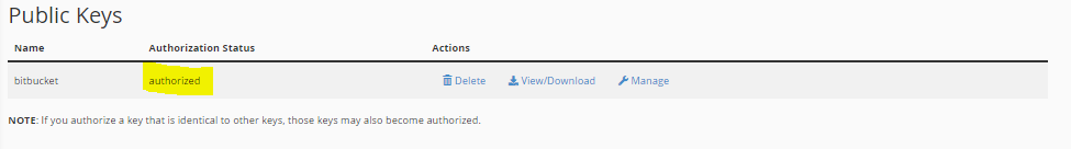

I also authorized the key :
I think it's mandatory that step 2 succeed right ? How should I fix that ?

- you have another server and you want to login over ssh there. I guess it is your case, but here you should check which ssh setup you have on your server. If it cannot verify fingerprint, recheck your ssh config there and try to get fingerprint from server itself. Read more about SSH fingerprint in https://docs.bmc.com/docs/display/itda27/About+the+SSH+host+key+fingerprint.
If you still fail with fingerprint, you may try to use rsync deploy with
`EXTRA_ARGS: StrictHostKeyChecking=no`. However, we don't recommend such approach, it is less secure.
Try to fetch the fingerprint for your host on your own (another helpful link: https://unix.stackexchange.com/questions/126908/get-ssh-server-key-fingerprint)
and check ssh server is at least up.
By the way, step 3 also seem strange to me, when you copy somewhere your public key to be authorized, you should not have there private ssh key and its passphrase, because private ssh key is stored only at the location to be authorized, not the issuer. This is the goal of private key. Please, explain more, what you do in Step 3, if you have already generated private and public keys at step 1.
However these may be independent failures, let's firstly figure out with ssh fingerprint on your server.
