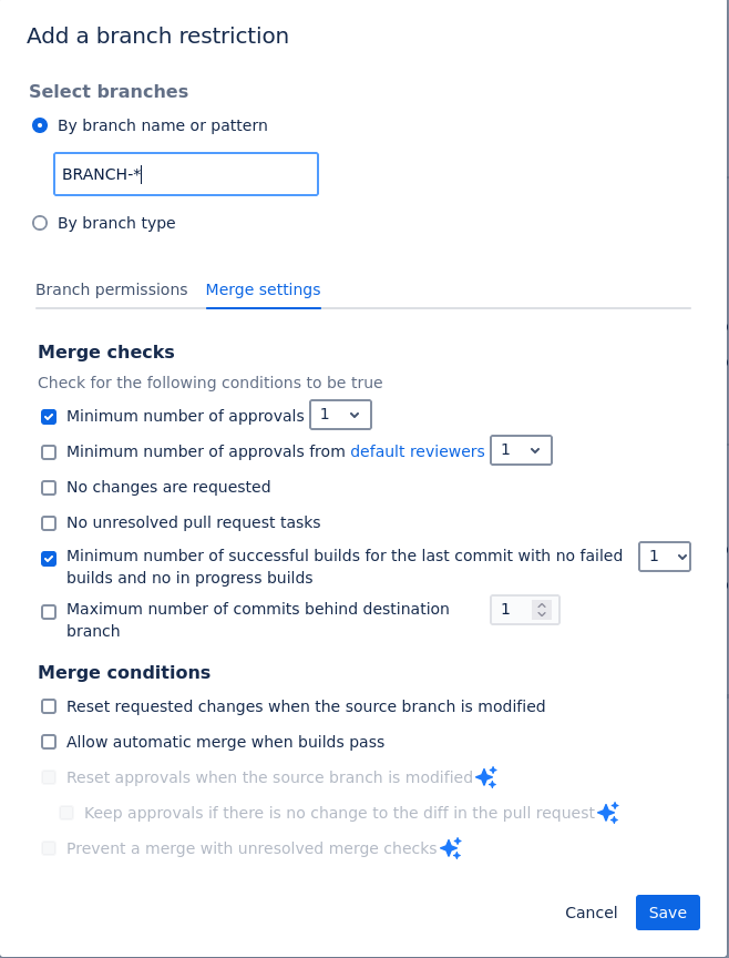

June 19, 2024
Hi @Saxea _Flowie_ ,
No i haven't selected this option because this option is part of the Premium plan.
You can see my configuration on the screenshot below.
Regards,
Saxea _Flowie_
Atlassian Partner
June 20, 2024
In order to block the merge using Bitbucket's built in checks you need premium. Flowie can enforce merge checks on non-premium, but is also a paid addon. It does give you other functionality like PR labels, draft, additional checks, rebase support and more.
