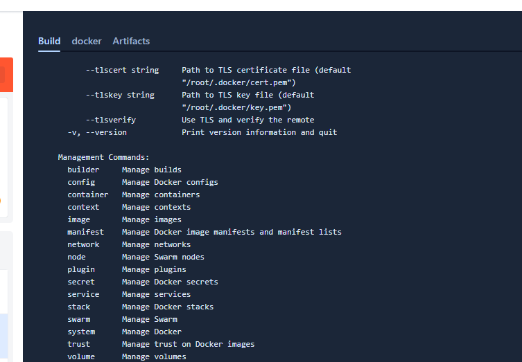

"docker scan" indeed is discontinues but with newer CLI 4.17.0, they have rolled out "docker scout". I think somewhere bitbucket has to update Docker CLI so that when I use "Docker" as a "Service" in my pipeline, bitbucket-pipeline is able to access scout command. Thoughts ?The reason I think is this, when I run "docker --version" on pipelines, I see: Docker version 20.10.18, build b40c2f6 vs when I run it on my local machine where "docker scout" works, I see: Docker version 20.10.23, build 7155243Another reason is, that when I run "docker --help" on pipelines, I don't see "scout" as a command under "Management Commands". What bothers me is that "scout" is not listed as a blocked command here. Attaching 2 pictures where you can see that Docker CLI on local machine supports scout or scan vs on Bitbucket it doesn't. (docker_help_local is local machine's screenshot and docker_help_bb is Bitbucket's screenshot)I think capability to run "docker scout" to scan the docker image built during deployment, is a necessity. Can you look into this please
It seems like the Docker scout is still in the early adopter phase and it currently comes just with Docker Desktop installation, but not with Docker engine CLI (which is used in pipelines). I went ahead and created a feature request to add support for docker scout in pipelines, which you can find in the link below :
I would suggest you to add your vote there, since this helps both developers and product managers to understand the interest. Also, make sure you add yourself as a watcher in case you want to receive first-hand updates from that ticket. Please note that all features are implemented with this policy in mind.
