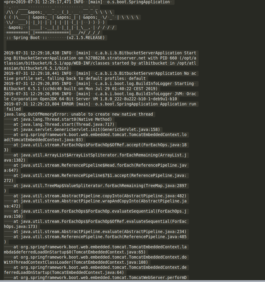

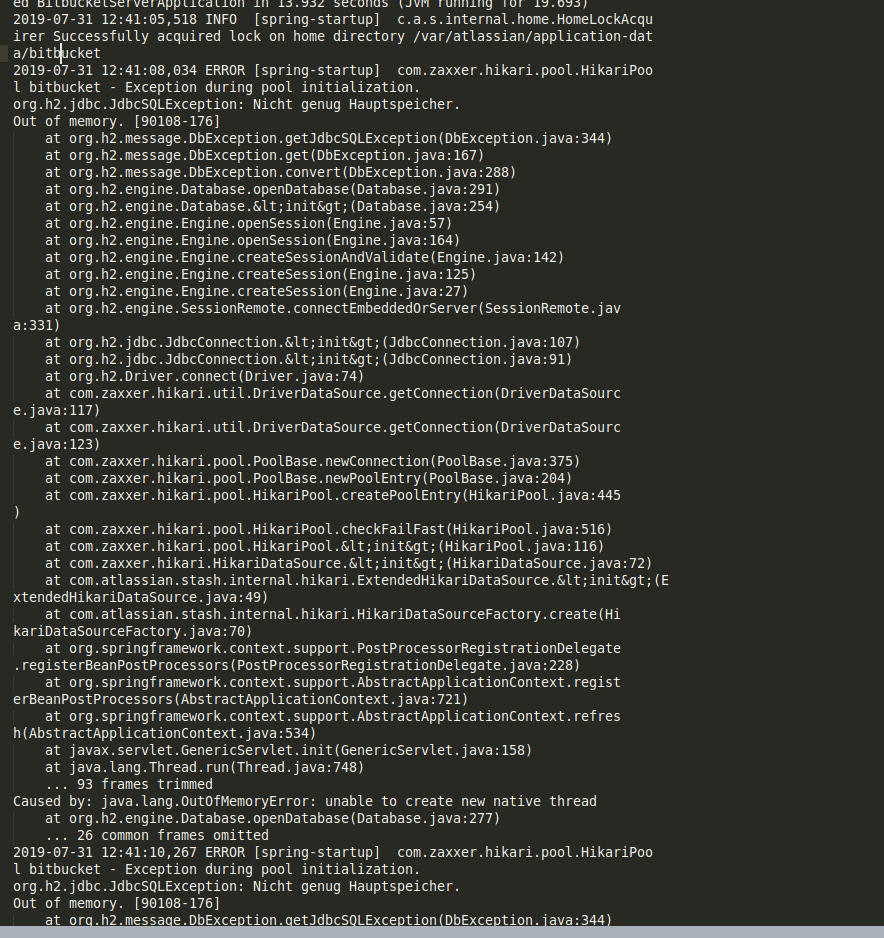

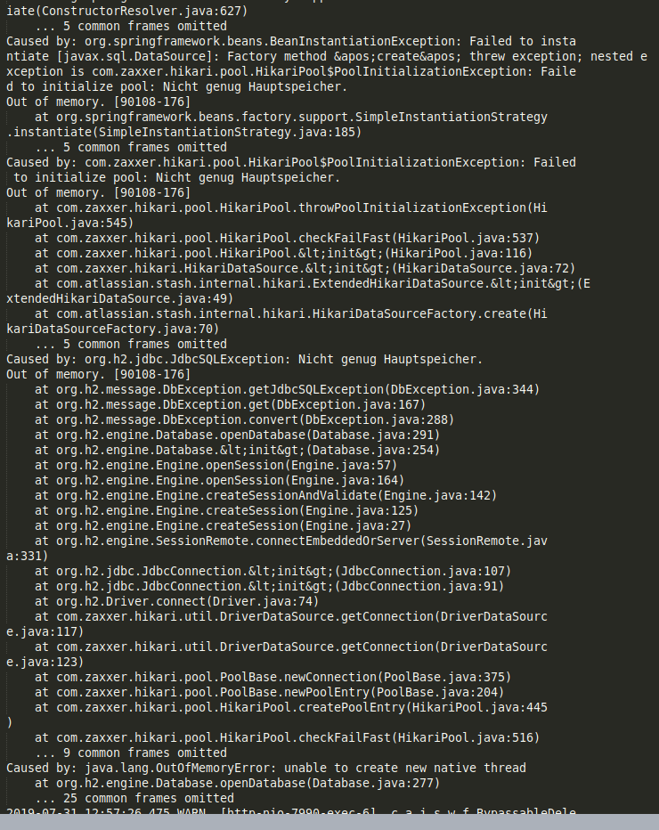

I took couple of screenshots of the atlassian-bitbucket.log file.
Thanks in advance for the help.
regards.
Willy.
Screenshot from 2019-07-31 14-46-44.pngScreenshot from 2019-07-31 14-47-16.pngScreenshot from 2019-07-31 14-47-57.pngScreenshot from 2019-07-31 14-48-50.png

ok, from your screenshot you're gettin Out Of Memory error right at the beginning.
You should try to check if your server has enough memory available (is Bitbucket the only tool running on it ? ) and adjust Bitbucket memory (in config file  _start-webapp.sh  ) settings to 2048m for example.
