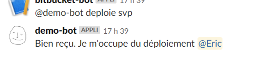

Hello, I was able to figure out a few things by myself.
Download section can effectively be used as a simple repository for the builds (instead of Nexus).
I had to manage a private server deployment, which made things more difficult, but was able to  build a simple proof of concept using Slack.
My Bitbucket Pipeline send a message to our project slack, a App Bot receive the message and complete the deployment (get the file from the download repository, I was able to get the list using a npm library for Bitbucket, I only have to complete the download (I currently get a aws error).
I will change the message format to have something like @Demo-bot deploie build-x-y-z en dev (have the build identifier or version and target environnement).
bitbot.pngThe default Slack pipe is not working for me (it's also quite heavy to spin a docker just for a curl call?), the slack RTM api is only reacting to message, not attachment, took me a bit of time to figure it out but it is working nicely.
So for self-service (on deploy, not the build), our QA will be able to use the slack channel to trigger the deploy using the same message used by the Bitbucket cloud-slack-private server bridge.
