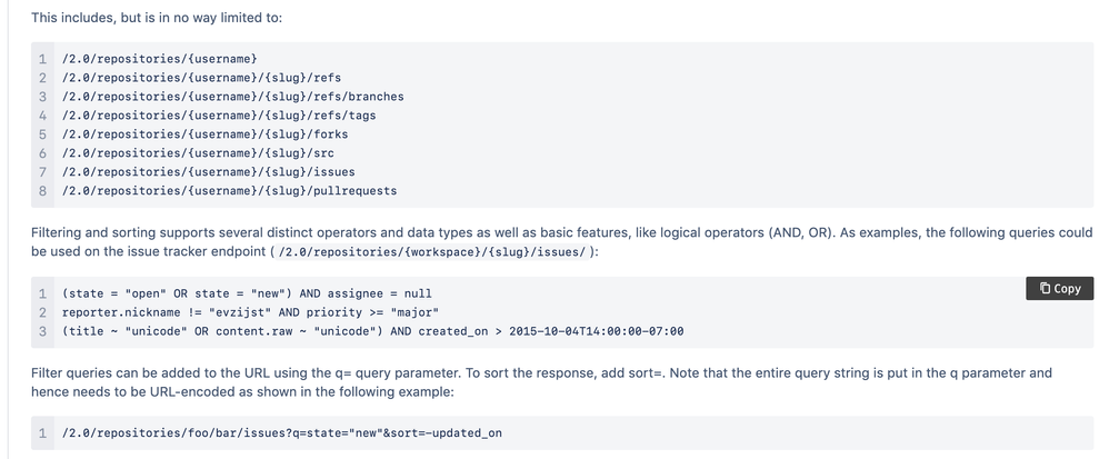

Here it's listed that we can use created_on to filter some of the following endpoint.
What I'm trying to achieve is to fetch all merged PRs between two release branches.
If this isn't possible, Is there any other way to achieve it?
https://developer.atlassian.com/cloud/bitbucket/rest/intro/#filtering
