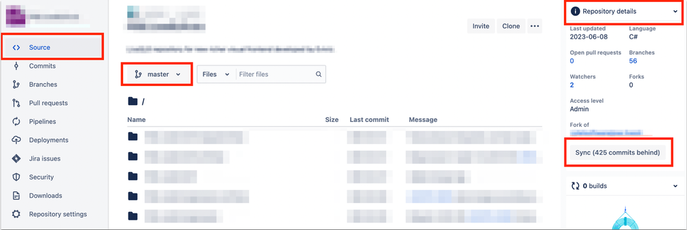

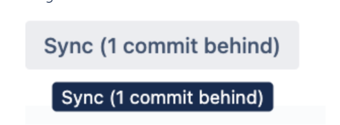

If you pushed new commits to the parent repository main branch, when accessing the fork repository a Sync button should indeed be shown in the side card named Repository details, which is located on the top right side of the page when you navigate the Source page of the repository, as in the image below :
By clicking on that Sync button, the main branch of the fork repo should be synchronized with the corresponding branch in the parent repo.

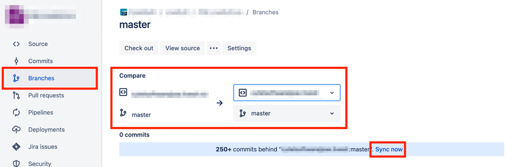

Another alternative to accessing the Sync option is by navigating to the Branches page, selecting the main branch, and comparing it to the parent's main branch, as shown below:
In both places, the Sync option will have the same result of synchronizing the fork's main branch with the parent main branch.
