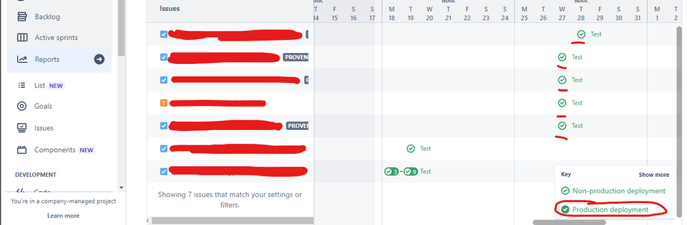

I see everything fine in BitBucket. I am not seeing it in Jira Deployments. Each day we had a deployment on Test, we also had a deployment on Prod. However, I am seeing only the test deployments in Jira Deployments:
Syahrul
April 17, 2024
Hey @Nikola G. Kalfov
This looks like an issue with Jira side and not Bitbucket. Can you raise a support ticket directly with the Jira team in our Support portal?
