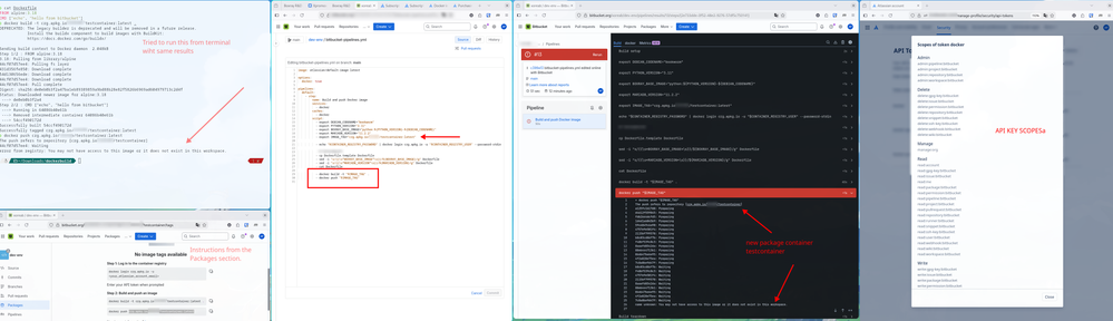

I have send in the latest screenshots every possible scenario that i try and settings and scopes.
I have done:
  1. make a new package to put the images name testcontainer
  2. New API with all the 40+ scopes (previously tried with api key and this scopes:- `read:repository:bitbucket`
    - `write:repository:bitbucket`
    - `read:package:bitbucket`
    - `write:package:bitbucket`)
  3. followed the packages section instructions:
  4. The Bitbucket is connected to the workspace: companynameworkspace
  5. The subscribtion plan is premium free trial. That Atlassian support told me could use for the docker testing.
  6. My user has admin right to bitbucket and the workspace, actuallt to everything.
  7. the login is succesful with my altasian account email and api key
  8. The api key was created under https://id.atlassian.com/manage-profile/security/api-tokens.
       10. tried via bitbucket-pipelines.yml and from the terminal in my laptop. where in both case i have succesfully login in to the Bitbucket via username and api key with ALL the scopes enabled
       11. then in both pipeline and terminal:
docker build -t crg.apkg.io/companynameworkspace/testcontainer:latest .
docker push crg.apkg.io/companynameworkspace/testcontainer:latest
and both cases same error:
error from registry: You may not have access to this image or it does not exist in this workspace.
