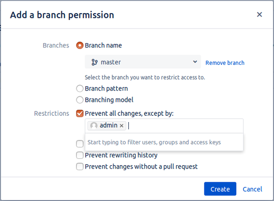

I am trying to put the following permission using REST APIs
With the following JSON

anoop maurya
August 23, 2018
Please, can anyone suggest what should be the JSON to prevent all changes on master/dev/release branches except admin? just like shown below in the screenshot.
awaiting for response.
Thanks
