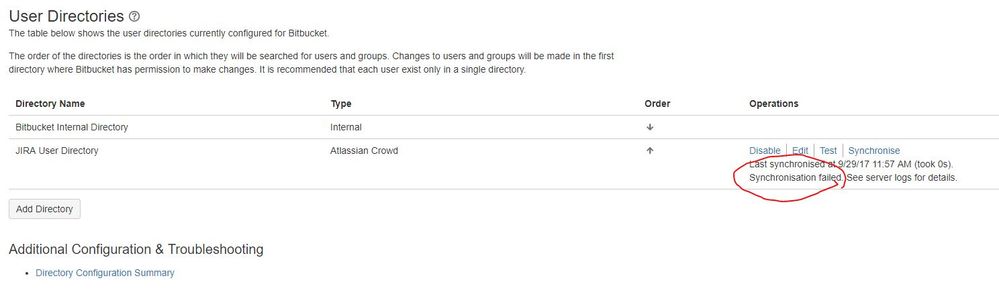

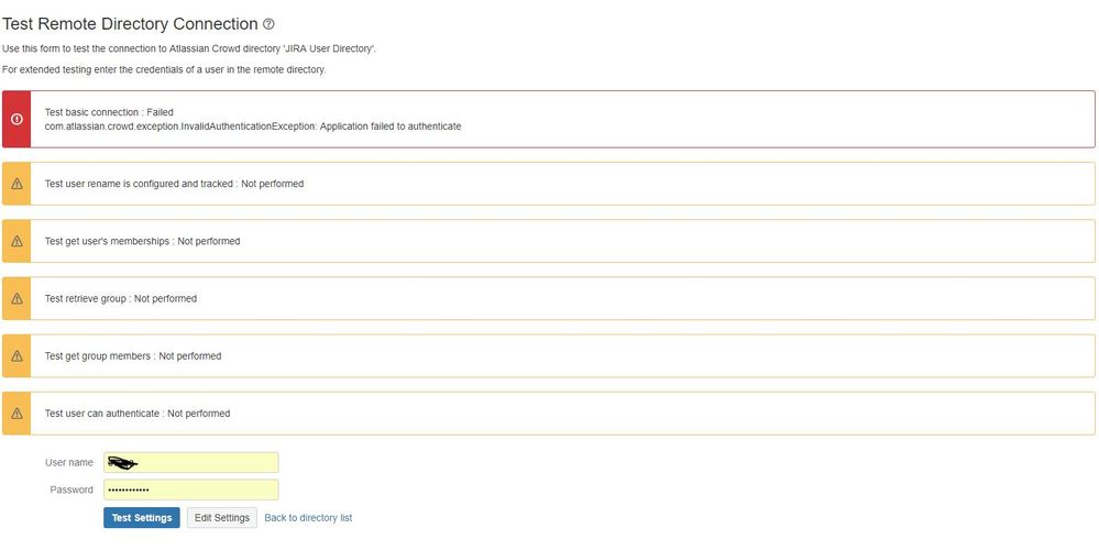

cesarvega
September 29, 2017
Capture.JPGIm getting this and I think this is the issue

cesarvega
September 29, 2017
Cristian is failing I did try the sync
Peter DeWitt
September 29, 2017
Cesar, there are a number of causes for this and without more information on how your server is configured it will be hard to pinpoint.  However, it looks like you are feeding users from another location or directory (Crowd, AD, LDAP).  Depending on the source you may not be able to make changes to the users hence the read-only user directory message. You couls also check you user directory configuration on Bitbucket and make sure that the directory listed is not configured to be read-only.  You will need to log on with a local account.
