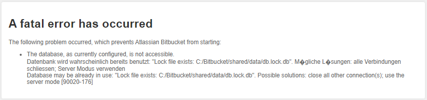

Hello,
I tried to start bitbucket server via start-bitbucket.bat file.
After this I get the error which is attached to this post.
Hope someone can help me with that!
Thanks in advance,
David
Hi @DavidJng ,
can you try stopping Bitbucket and removing C:/Bitbucket/shared/data/db.lock.db manually ? You can then restart and see if it fixes your issue.
Let me know if this works,
--Alexis

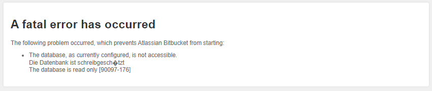

Hi @Alexis Robert ,
thanks for your answer.
After deleting the file and restarting the server the attached error occures.
On C:/Bitbucket every user has all permissions.
Hi @DavidJng ,
looks like an issue with your local database. What database did you use ? Can you restart it ? It looks like it's not running as the error is "Database not accessible".
