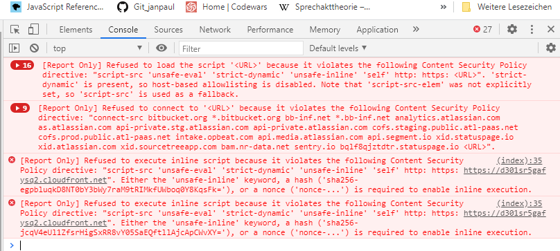

I coded a static page using gatsby and deployed it. :80 is no problem, also when i hosted it on a github static page the console didnt spammed errors. For each <GatsbyImage/> i am using in my project, i get this chrome-console-error on my static page.
[Report Only] Refused to connect to '<URL>' because it violates the following Content Security Policy directive:
"connect-src bitbucket.org *.bitbucket.org bb-inf.net *.bb-inf.net analytics.atlassian.com as.atlassian.com
api-private.stg.atlassian.com api-private.atlassian.com cofs.staging.public.atl-paas.net cofs.prod.public.atl-paas.net intake.opbeat.com api.media.atlassian.com api.segment.io
xid.statuspage.io xid.atlassian.com xid.sourcetreeapp.com bam.nr-data.net sentry.io bqlf8qjztdtr.statuspage.io <URL>".
Can someone point me to 1. understand the problem 2. handle it properly to avoid all this console errors. i hate errors in live projects ;-)

While my dev build contains only dev-warnings produced by from eslint and webpack, i cannot confirm other errors then which you can see here:

I spoke with one of the developers regarding this, these errors in the console are for reporting purposes only for our engineering team, they should appear on every Bitbucket page at the moment. They don't represent anything breaking and I'm afraid that they cannot be avoided.
