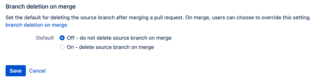

How to enable “branch deletion on merge” for Bitbucket projects via REST API?

I found the answer:
Bitbucket Server 7.15
Branch deletion on merge
New Java and REST API methods have been added to configure Branch deletion on merge for Project and Repository.
DeleteAfterMergeConfigurationService.deleteConfiguration(scope), DeleteAfterMergeConfigurationService.getConfiguration(scope) and DeleteAfterMergeConfigurationService.setConfiguration(DeleteAfterMergeConfigurationRequest) introduce the ability to configure Branch deletion on merge feature.
New REST endpoints:
PROJECT
  • GET /rest/branch-utils/latest/projects/{key}/delete-after-merge
get if the feature is enabled for a Project.
  • POST /rest/branch-utils/latest/projects/{key}/delete-after-merge
enable or disable the feature for a Project.
REPOSITORY
  • GET /rest/branch-utils/latest/projects/{key}/repos/{slug}/delete-after-merge
get if the configuration is enabled for a Repository.
  • POST /rest/branch-utils/latest/projects/{key}/repos/{slug}/delete-after-merge
enable or disable the configuration for a Repository.
  • DELETE /rest/branch-utils/latest/projects/{key}/repos/{slug}/delete-after-merge
delete the configuration for a Repository.
