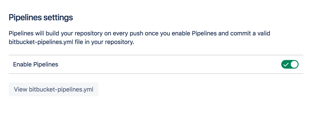

Can you double check that Pipelines is enabled?
Repository Settings -> Pipelines -> Settings

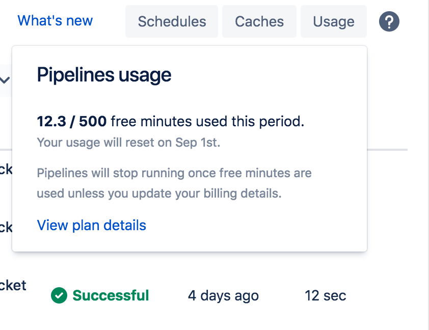

Screen Shot 2018-08-10 at 2.04.12 pm.pngYou may also be out of build minutes. You can check that on the main Pipelines page:
matloob August 9, 2018
Yes, it works when I push to master. 'default' is deployed.
13.1 / 50 free minutes used this period.
