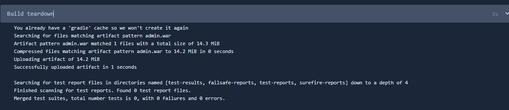

Hello,
I have been writing my bitbucket-pipelines.yml which includes artifacts in order to pass the generated war file during the building process for the next step(deployment)
However, the war is compressed as tar.gz.
Can I just upload admin.war to artifacts as it is?
The uploaded file is named as "artifact_2dfe02f9-78ba-4a44-9a33-b5bb96decd64.tar.gz"
My bitbucket-pipelines.yml is as follows.

Hi @JJ지우근,
I believe that the file name you mentioned, artifact_2dfe02f9-78ba-4a44-9a33-b5bb96decd64.tar.gz, is the name of the file when you download the artifact from the Artifacts tab of the Pipelines build log, is that correct?
This doesn't have anything to do with the error you are seeing in the deployment step:
File admin.war doesn't exist.
I think the culprit for this error may be the parallel keyword in your yaml file: parallel steps can only use artifacts produced by previous steps, not by steps in the same parallel set. If both of these steps belong to the same parallel set, then the 2nd one won't be able to use the artifacts generated by the first one.
Are these two steps the only ones in your yaml file? If so, can you remove the parallel keyword from the yaml file and run another build? The admin.war file should then be available for the second step, and the file should be uploaded in the Downloads section of the repo with the same name.

JJ지우근
October 5, 2021
After removing the parallel keyword, I have been able to upload the file to downloads.
Thanks for your support.
