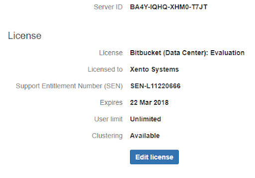

-- For this, should I install bit bucket server on node2, or bit bucket data center.
My first node SSN number is: SEN-L11220666
Danyal Iqbal
February 21, 2018
You need Data centre on all nodes.

First node details..

In license I am able to see same server id for both node or servers, is it correct?
Regards,
Danyal Iqbal
February 21, 2018
Yes, you should see the same id on both nodes.

clustering can only be possible with bitbucket data center versions/licenses. Pls refer to this guide on data center setup.
Rohit Shukla
February 14, 2018
Thank you Shankar,
Yes, have bitbucket data center version on both servers.
