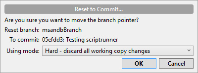

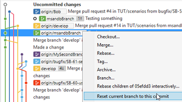

The changes you pushed to your master branch, where they done on a separate branch that you merged into master or was it all done one master? In order to clear out the errors you currently see I would to a git reset to get back to the same commit Bitbucket knows about. In Sourcetree click on the commit that you want to revert, right-click on it and select Reset current branch to this commit and select Hard as the mode to use
This should remove any uncommitted changes. You can now try and do a revert to roll back your changes on master.

As long as you reset back to the commit you made you should be fine. An example:
In this example I uncommitted changes and I want to reset my branch to the commit that my remote copy of the branch knows. It will basically delete my uncommitted changes and the commit called Testing something. Note that this is all done locally and Sourcetree will not push anything back to Bitbucket since you are not committing anything. Once you are back to the commit you made, you can do a revert of it. Your other option is to clone the repository again and then do a revert, that will have the same effect.
