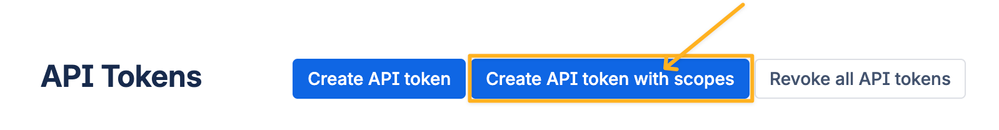

A coworker of mine let me know that when creating an API token that he had to select "Create API token with scopes". I tried it and it indeed worked! I have no idea why it doesn't work with just the "Create API token" option. Maybe it's an Xcode thing, but there's nothing that lets the user know that.

To start using API tokens - you'll need to create the API token and specify the scope - this is mentioned in our deprecation documentation:
  1. Click the gear cog icon, select Atlassian Account settings > Security tab > Create and manage API Tokens
  2. Click Create API token with scopes and select Bitbucket Cloud
  3. If you want to be able to clone/push/pull to the repository - you'll need to tick both read:repository:bitbucket and write:repository:bitbucket - clone only would just be read:repository:bitbucket. More information on scopes can be found in our API scopes documentation.

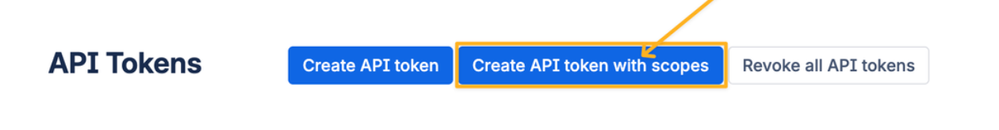

To use the API Token with Xcode:
1. Create an "API token with scopes" and save it.
API Token.png2. In Xcode settings, add a source control account using your email and not your Bitbucket username, and the API Token as the password.

I did create a Token with scopes sorry I'll update my answer.
