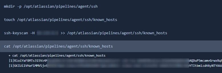

Andrés Soria
November 17, 2021
Hi @Igor Stoyanov
I've been trying to update /opt/atlassian/pipelines/agent/ssh/known_hosts on different ways but always end with same result : Host key verification failed.
As you can see in the picture, i'm able to update known_hosts file but bitbucket seems to not use it.
So, i figured it out by adding
SSH_ARGS: '-o StrictHostKeyChecking=no'
to my bitbucket-pipelines.yml
It won't be the prettiest deployment but i think i can continue with it.
Thanks a lot for your help
