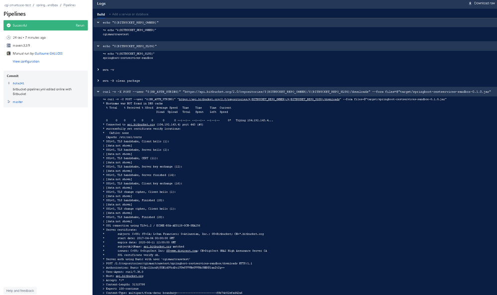

I want to deploy a builded jar form simple pipeline to dowload page.
I already saw this post : https://bitbucket.org/site/master/issues/13919/deploy-build-artifacts-to-bitbucket but can't find the solution ...
  • I've created an App passwords in my account
  • Add an Environment variables BB_AUTH_STRING in the team level with the user cgismartcasetest (not from repository or account level)
  • Update the pipele with the curl command
The repository is from the team name 'cgi-smartcase-test' (id 'cgismartcasetest') and is the owner of the repository
Here some log :
echo "${BITBUCKET_REPO_OWNER}"
+ echo "${BITBUCKET_REPO_OWNER}"
cgismartcasetest
echo "${BITBUCKET_REPO_SLUG}"
+ echo "${BITBUCKET_REPO_SLUG}"
springboot-restservices-sandbox
Here the log for the curl command :
+ curl -v -X POST --user "${BB_AUTH_STRING}" "https://api.bitbucket.org/2.0/repositories/${BITBUCKET_REPO_OWNER}/${BITBUCKET_REPO_SLUG}/downloads" --form files=@"target/springboot-restservices-sandbox-0.1.0.jar"

Thanks you
