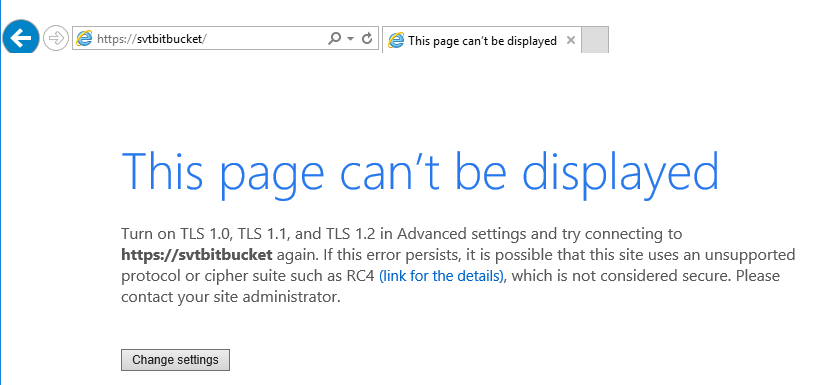

Getting the attached error after enabling SSL over HTTP.

Hi Tony,
This error can be caused by a few reasons, two of which would be more common:
  1. IE11 is running in compatibility mode, or it is set to run the document under an earlier version.
  2. There is an issue with the SSL config.
Please try and turn off IE11's compatibility mode if it is enabled. Also, check other machines and even other browsers such as chrome or firefox to see if they get the same or similar error.
Read through if not already the instructions at "Proxying and securing Bitbucket Server" and confirm your setup is configured correctly.

Thank you for the reply Edward! We have followed the instructions located here: https://confluence.atlassian.com/bitbucketserver/securing-bitbucket-server-with-tomcat-using-ssl-776640127.html
There is one line that is suggested within the bitbucket.properties file that will crash the services when they start: server.ssl.enabled=true
That entry should be: security.require-ssl=true
The service will start and then fail for an 'Incorrect function' in the event logs if the option shown in the documentation link is configured.
Once the service is running per the document and the above change the page loads to what Tony posted above. The error seems like the spring-boot web server is using an older TLS version even though we've tried to force TLSv1.2.

In your configuration you state that you only want to enable TLS 1.2, but Internet Explorer is telling you that TLS 1.2 is not enable in IE itself - you'll need to enable that in IE: https://support.freshdesk.com/support/solutions/articles/222861-enabling-tls-1-1-and-tls-1-2-in-internet-explorer

Corporate policy already has those enabled, screenshot below:
