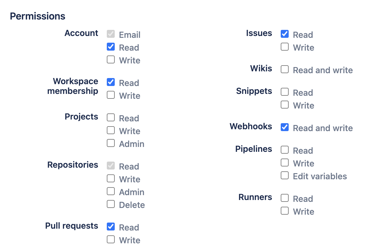

Screenshots:
To provide more context, I've included the following screenshot for OAuth consumer permissions:
I would appreciate any guidance or suggestions from the community regarding the possible causes of this issue and how it might be resolved. Are there any additional steps I should take to further troubleshoot the problem, or any known issues that could be causing such an error when using OAuth consumers for admin users?

Hi Amin and welcome to the community!
This error doesn't have anything to do with the OAuth consumer, it occurs when the list of commits involved in the PR doesn't exist. This can happen if someone rewrites history or rebases and with a force push removes commits associated with a pull request. The API then returns a 404 error with this message since the list of commits doesn't exist.
