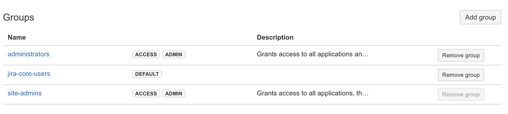

I had site-admin already. These are my groups:
My be I did something wrong, but before I got "administrator" group I tried the same process with no success but at least without this error. Now I see some webhooks defined in bitbucket but they are read-only, I can't remove them. And when I repeat adding JIRA I get this error described in the topic. It's still there.

@Yuri Pimenov If you are actually using JIRA Software Cloud, you should be in the relevant license group like jira-software-users. I see in your previous screenshot that you are just a JIRA Core user, which makes me think that either you are only using JIRA Core Cloud or you are not being added to jira-software-users group that provides access to JIRA Software Cloud.
Could be. Will try to understand what's the difference and may be our company needs too upgrade Jira license for that?
@Yuri Pimenov Please refer this page to understand the difference between 3 flavors of JIRA: JIRA Core, JIRA Software and JIRA Service Desk.
You will definitely need additional license for JIRA Software Cloud.
