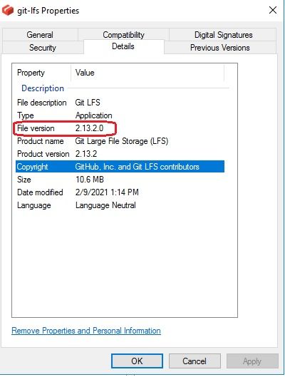

3) if I check the version by the properties of git LFS, we have the version 2.13.2.0 (last version).  When we type $ git lfs version by command, we have no result or no output in the console. We have the same thing for the other lfs command. (git lfs install, git lfs clone: no output).

1. You mention
It's a bit unclear to me where you check that, and what you mean by properties of Git LFS. Could you please explain where you see that, and/or attach a screenshot that shows where you see this?

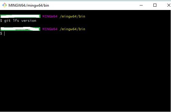

Neovia-IT Administrator February 16, 2021
1. I checked the properties details by this path "C:\Program Files\Git\mingw64\bin\git-lfs.exe" (Windows)
2/ 3 - I use gitExtension but tested with gitBash for Windows.

Theodora Boudale
February 19, 2021
Hi @Neovia-IT Administrator ,
Thank you for the info.
It seems strange that you get no output at all from the commands git lfs version and also git lfs install. This sounds like an issue with the local installation, my suggestion would be to try uninstalling Git Bash and install it again, and then try to install LFS again with git lfs install.
