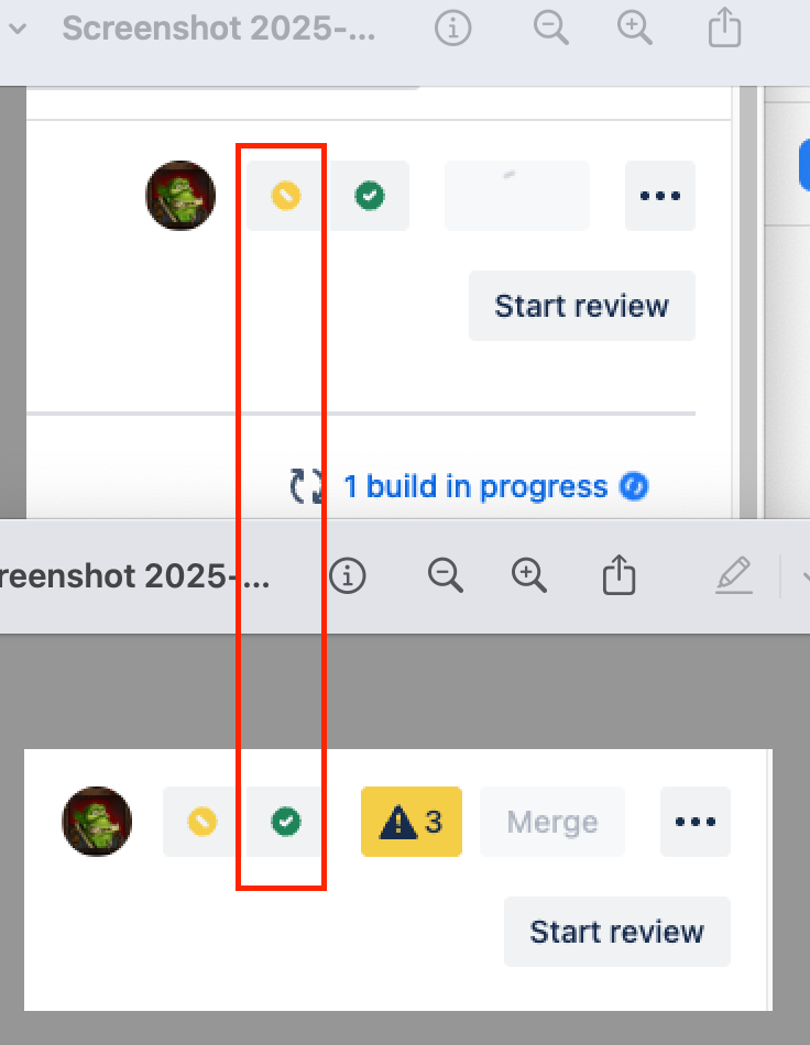

Kevin McCray
June 20, 2025
Maybe the correct term is "merge blocking issues" ?
Here is lined up screenshot right upon page load (top -- no yellow hazard) and one after page load (bottom -- has yellow hazard inserted and pushes everything to the left).
I am running the latest Chrome on a Mac M2 Pro.

Ben
June 22, 2025
Hi @Kevin McCray
Based on the screenshot you've shared - it appears you're using Bitbucket Server/DC - not Bitbucket Cloud. Am I correct?

Kevin McCray
June 23, 2025
You're right! My mistake, this is not bitbucket cloud. I assumed we were using cloud since we recently migrated to Jira / Confluence cloud.
We're on Atlassian Bitbucket v8.19.3
