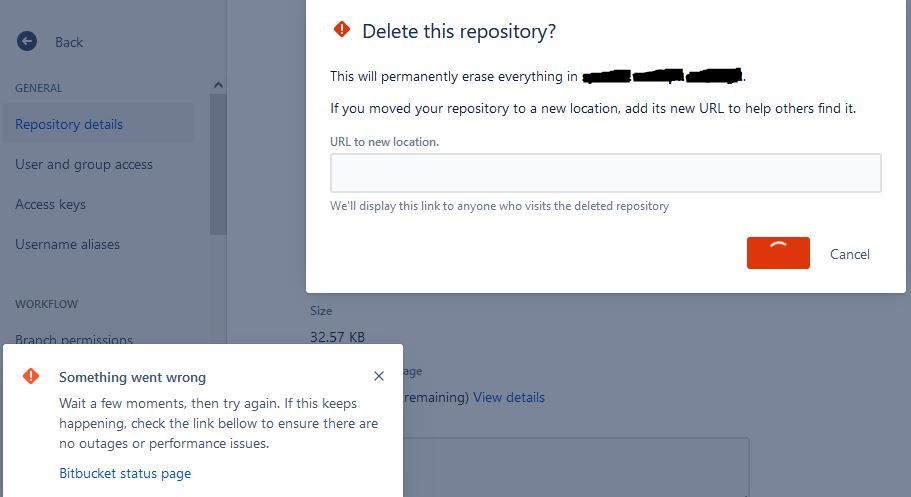

I am trying to delete a Bitbucket Cloud repository. I navigate through Repository settings -> Repository details -> Manage repository -> Delete repository -> Delete.
When I click on delete I get the below pop-up:
It's the same for last 1 day. When I checked with the Bitbucket Status Page, everything is operational.
Additional Info:
I am facing this issue in the repositories for which I had tried to rename the repository using REST API. For other repositories which I don't rename, I am able to delete it. I believe it's a bug from Bitbucket.

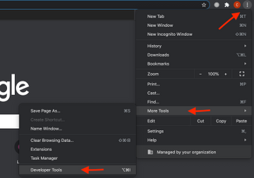

  • Open the "Developer tools" in the browser you are using (click on the three dots > More tools > Developer Tools):

Thanks for sharing the sentry code with us. I checked that and it corresponds to the below error:
ProjectPrivacyException: A repository in a private project cannot be publicly visible.
So the repository you are trying to delete is set as public, but the project that has this repository is private. This is the cause of this issue.
