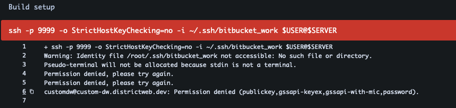

Here is one of the error :
The main problem i see is that I tell the pipeline to go to ~/.ssh/ but in the pipeline command you see that it goes to /root/.ssh/.
On the server where I connect, I do not have access to the /root/ but ~ I have.
I know that the credentials works because in my terminal, if I run the same command, I'm able to connect but i'm never in root.
Is it possible to make the pipeline not ask for root but ~ ?
