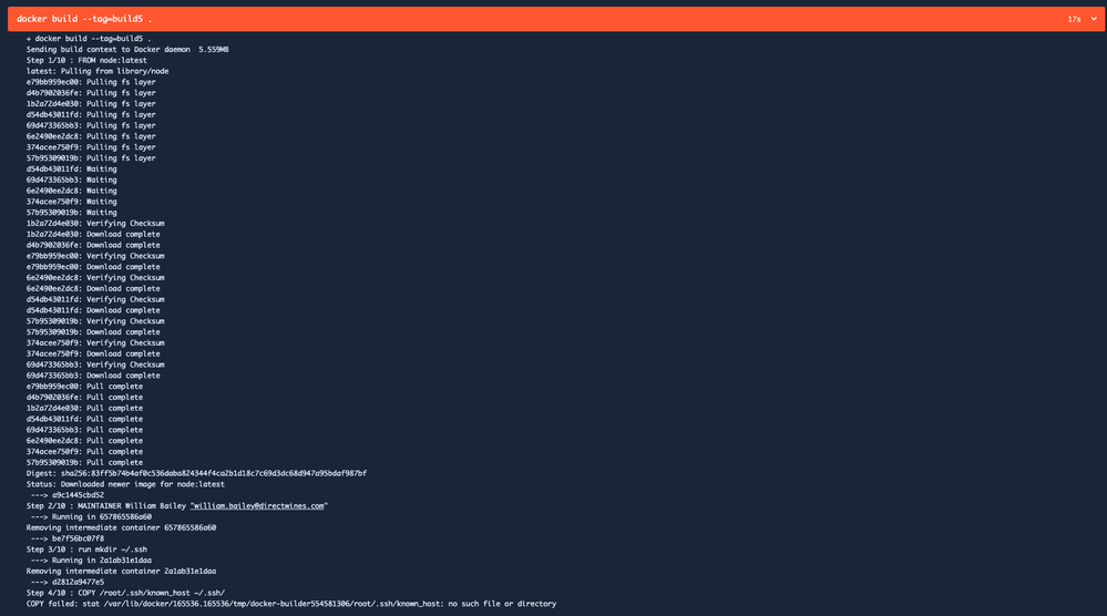

Thanks for this @Leonardo M . I have added the commands to the top of my dockerfile which now looks like this -
FROM node:latest
MAINTAINER
run mkdir ~/.ssh
COPY /root/.ssh/known_host ~/.ssh/

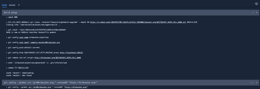

This is the result when running the pipeline.
Can you see anything obvious that may be causing it to still fail?
Your help is greatly appreciated - Thank you! :)
