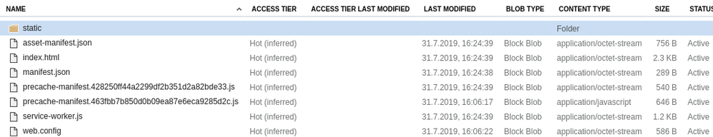

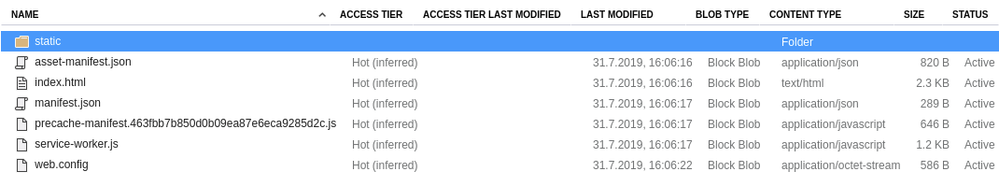

When I use Azure Storage deploy v1.1.1 to deploy static website build files to blobstore, the files are uploaded and the content-type is set to application/octet-strem. This is a problem, because when you then visit the static website, the index.html file is downloaded as a file instead of shown as a web page
I need *.html files to be uploaded with content-type text/html and *.js files as application/javascript

Desired result:
Actual result:

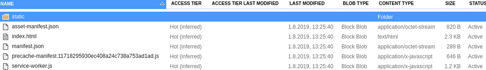

I found the source code for this pipe suggested that the version of azcopy they use is v7.3 and the documentation for azcopy mime-content-type gave me the --set-content-type flag, which solved alot of my problems.
But svg and json files are still being set to type application/octet-stream
