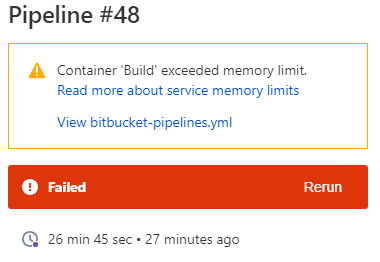

Hi Folks,
I'm try to build a 1.5gb GWT app and running into some problems, I get a message container "Build" running out of memory.
I read that "The build container is always allocated 1024 MB of this, which covers your build process and some Pipelines overheads (agent container, logging, etc)." here
I've increased the pipeline step to max size and increased the memory available to the maven service to max
My configuration
image: maven:3.5.4
pipelines:
default:
- step:
caches:
- maven
script:
- mvn clean install
definitions:
services:
maven:
image: maven:3.5.4
memory: 7128
note: The GWT portion of the app requires additional memory
-Dgwt.extraJvmArgs="-Xms1g -Xmx2g"
That's the furthest its run, was building the war this time. so close!
Am I missing something?
The problem was GWT.. (
-Dgwt.extraJvmArgs="-Xms1G -Xmx2G") 2 gig is enough to compile a single instance but GWT compiles multiple permutations so at one stage I was using 5 x 2G hence exceeding 8G limit
I found my solution here, check out the diagrams: https://www.sencha.com/blog/using-the-gwt-compiler-for-better-builds-2/
GWT has a number of setting to reduce memory requirements during compile, most result in longer build times but that OK
