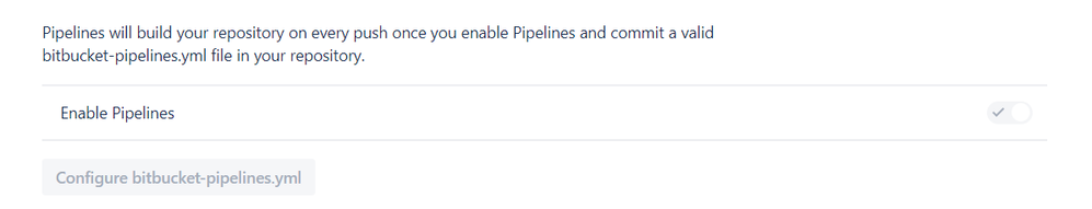

Hi!
I cannot Enable Pipelines
I see a lot of issues about it, but I cant see any solution to fix it
When we try enable it the button showed a tick greyed out. But after page refreshing it again shows like disabled
I have the second repository and everything is okay with pipelines enabling
Would someone tell me how to enable pipelines for the bitbucket repository?

I ran into the same problem and found that an underlying API response threw out the error "Two-step verification must be set up for this user in their Bitbucket settings to enable pipelines in this workspace" but doesn't actually show you that on the UI. I suggest trying this..

Hi there,
I had the same problem, i talked to my boss and when he enable it, it worked perfectly, so if you are not the creator maybe talk to him/her and tell the then to do it.

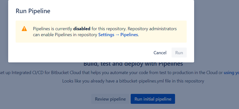

I tried switch on pipelines in settings with 2 option:
1. With bitbucket-pipelines.yml file in repo
2. Without.
In first case when I try to run initial pipeline I see
"Pipelines is currently disabled for this repository. Repository administrators can enable Pipelines in repository Settings -> Pipelines."

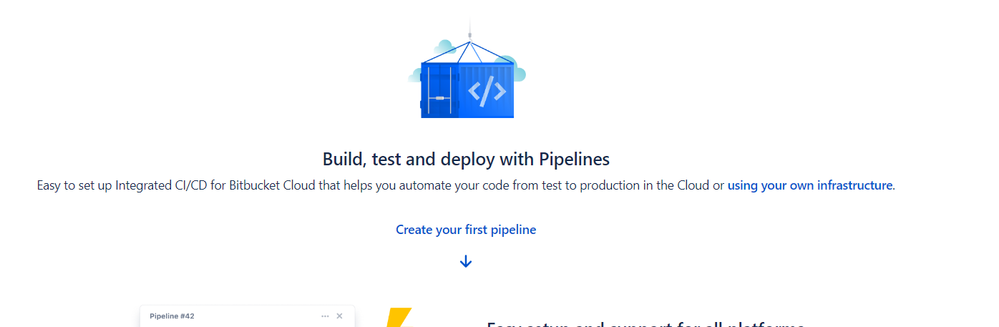

In second case it ask me create "my first pipeline"

Hi Ivan,
What happens when you click "Create your first pipeline"? This is a setup wizard that will create the yml file and establish webhooks so this should not already be present.

Hi Ban
If I press "Create your first pipeline" it transfer me to the IDE where I can create pipeline

Ivan Tkachuk
February 21, 2024
I have this issue also on 2 repos
The same - I just cannot apply "Enable Pipelines" even I have bitbucket-pipelines.yml in repos.

February 21, 2024
Okay so, when you state "It transfers me to the IDE where I can create Pipeline" may I see a screenshiot? Does it let you complete the wizard?
To be clear, you should not have a bitbucket-pipelines.yml file until Pipelines is enabled, as this can cause issues with the wizard.
