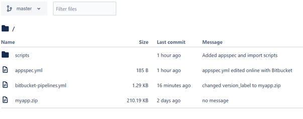

This is my directory structure in bitbucket repository:
image.pngAll help, hints, suggestions welcome. Thank you for helping out.

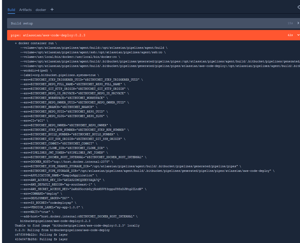

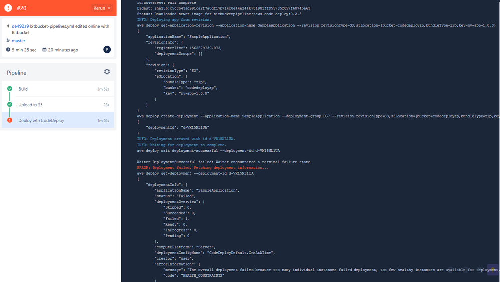

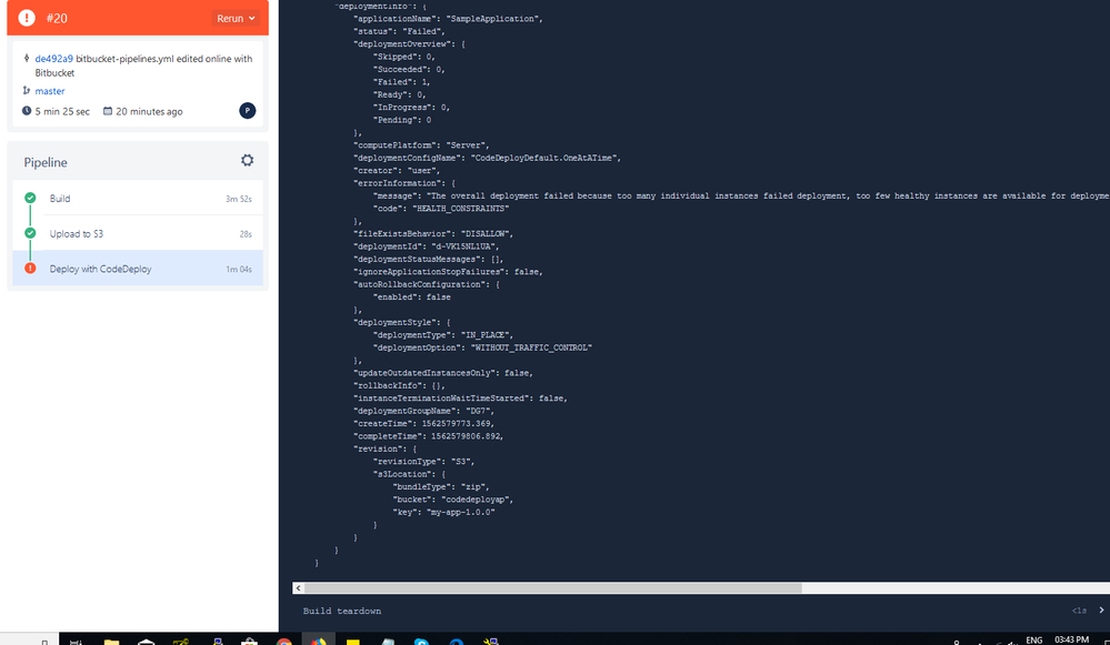

Please find the atatched logs :-Capture0.PNGCapture01.PNGCapture02.PNG
Hitendra Verma
July 19, 2019
hi,
from your screenshots, all steps look correct and the application revision and s3 bucket name all match.
at this point you need to check your application setup in codedeploy and make sure that codedeploy is able to deploy to the EC2 instance that you have selected as a target. Try checking the IAM role, instance tag, and permissions to allow codedeploy to access the EC2 instances you need.
