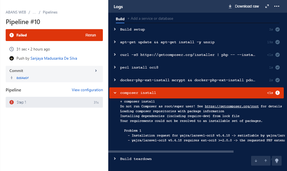

×Cannot install composer due to oci8.
Could you provide the full error logs?
+ umask 000
+ git clone --branch="production" --depth 50 https://x-token-auth:$REPOSITORY_OAUTH_ACCESS_TOKEN@bitbucket.org/abansweb2/common-api.git $BUILD_DIR ; git reset --hard 487421a49a256fa12ef094cfc1cc00f8e06fea3a ; git remote set-url origin git@bitbucket.org:abansweb2/common-api.git
Cloning into '/opt/atlassian/pipelines/agent/build'...
HEAD is now at 487421a bitbucket-pipelines.yml edited online with Bitbucket
+ chmod 777 $BUILD_DIR
Cache "composer": Downloading
Cache "composer": Not found
+ apt-get update && apt-get install -y unzip
Get:1 http://security.debian.org jessie/updates InRelease [63.1 kB]
Get:2 http://security.debian.org jessie/updates/main amd64 Packages [632 kB]
Ign http://deb.debian.org jessie InRelease
Get:3 http://deb.debian.org jessie-updates InRelease [145 kB]
Get:4 http://deb.debian.org jessie Release.gpg [2434 B]
Get:5 http://deb.debian.org jessie Release [148 kB]
Get:6 http://deb.debian.org jessie-updates/main amd64 Packages [23.1 kB]
Get:7 http://deb.debian.org jessie/main amd64 Packages [9064 kB]
Fetched 10.1 MB in 4s (2177 kB/s)
Reading package lists...
Building dependency tree...
Reading state information...
Suggested packages:
zip
The following NEW packages will be installed:
unzip
0 upgraded, 1 newly installed, 0 to remove and 67 not upgraded.
Need to get 162 kB of archives.
After this operation, 395 kB of additional disk space will be used.
Get:1 http://deb.debian.org/debian/ jessie/main unzip amd64 6.0-16+deb8u3 [162 kB]
debconf: delaying package configuration, since apt-utils is not installed
Fetched 162 kB in 0s (195 kB/s)
Selecting previously unselected package unzip.
(Reading database ... (Reading database ... 5% (Reading database ... 10% (Reading database ... 15% (Reading database ... 20% (Reading database ... 25% (Reading database ... 30% (Reading database ... 35% (Reading database ... 40% (Reading database ... 45% (Reading database ... 50% (Reading database ... 55% (Reading database ... 60% (Reading database ... 65% (Reading database ... 70% (Reading database ... 75% (Reading database ... 80% (Reading database ... 85% (Reading database ... 90% (Reading database ... 95% (Reading database ... 100% (Reading database ... 12250 files and directories currently installed.)
Preparing to unpack .../unzip_6.0-16+deb8u3_amd64.deb ...
Unpacking unzip (6.0-16+deb8u3) ...
Setting up unzip (6.0-16+deb8u3) ...
+ curl -sS https://getcomposer.org/installer | php -- --install-dir=/usr/local/bin --filename=composer
All settings correct for using Composer
Downloading...
Composer (version 1.6.3) successfully installed to: /usr/local/bin/composer
Use it: php /usr/local/bin/composer
+ pecl install oci8
downloading oci8-2.1.8.tgz ...
Starting to download oci8-2.1.8.tgz (194,154 bytes)
.........done: 194,154 bytes
11 source files, building
running: phpize
Configuring for:
PHP Api Version: 20160303
Zend Module Api No: 20160303
Zend Extension Api No: 320160303
Please provide the path to the ORACLE_HOME directory. Use 'instantclient,/path/to/instant/client/lib' if you're compiling with Oracle Instant Client [autodetect] : building in /tmp/pear/temp/pear-build-defaultuservKz3Bk/oci8-2.1.8
running: /tmp/pear/temp/oci8/configure --with-php-config=/usr/local/bin/php-config --with-oci8
checking for grep that handles long lines and -e... /bin/grep
checking for egrep... /bin/grep -E
checking for a sed that does not truncate output... /bin/sed
checking for cc... cc
checking whether the C compiler works... yes
checking for C compiler default output file name... a.out
checking for suffix of executables...
checking whether we are cross compiling... no
checking for suffix of object files... o
checking whether we are using the GNU C compiler... yes
checking whether cc accepts -g... yes
checking for cc option to accept ISO C89... none needed
checking how to run the C preprocessor... cc -E
checking for icc... no
checking for suncc... no
checking whether cc understands -c and -o together... yes
checking for system library directory... lib
checking if compiler supports -R... no
checking if compiler supports -Wl,-rpath,... yes
checking build system type... x86_64-unknown-linux-gnu
checking host system type... x86_64-unknown-linux-gnu
checking target system type... x86_64-unknown-linux-gnu
checking for PHP prefix... /usr/local
checking for PHP includes... -I/usr/local/include/php -I/usr/local/include/php/main -I/usr/local/include/php/TSRM -I/usr/local/include/php/Zend -I/usr/local/include/php/ext -I/usr/local/include/php/ext/date/lib
checking for PHP extension directory... /usr/local/lib/php/extensions/no-debug-non-zts-20160303
checking for PHP installed headers prefix... /usr/local/include/php
checking if debug is enabled... no
checking if zts is enabled... no
checking for re2c... re2c
checking for re2c version... 0.13.5 (ok)
checking for gawk... no
checking for nawk... nawk
checking if nawk is broken... no
checking for Oracle Database OCI8 support... yes, shared
checking PHP version... 7.1.1, ok
checking OCI8 DTrace support... no
checking size of long int... 8
checking checking if we're on a 64-bit platform... yes
configure: WARNING: OCI8 extension: ORACLE_HOME is not set, looking for default Oracle Instant Client instead
checking Oracle Instant Client directory... configure: error: Oracle Instant Client directory /usr/lib/oracle/.../client64/lib libraries not found. Try --with-oci8=instantclient,DIR
ERROR: `/tmp/pear/temp/oci8/configure --with-php-config=/usr/local/bin/php-config --with-oci8' failed
+ docker-php-ext-install mcrypt && docker-php-ext-install pdo_mysql
+ cd mcrypt
+ phpize
Configuring for:
+ ./configure
checking for mcrypt support... yes, shared
configure: error: mcrypt.h not found. Please reinstall libmcrypt.
+ docker-php-ext-enable oci8
error: /usr/local/lib/php/extensions/no-debug-non-zts-20160303/oci8 does not exist
usage: /usr/local/bin/docker-php-ext-enable [options] module-name [module-name ...]
ie: /usr/local/bin/docker-php-ext-enable gd mysqli
/usr/local/bin/docker-php-ext-enable pdo pdo_mysql
/usr/local/bin/docker-php-ext-enable --ini-name 0-apc.ini apcu apc
Possible values for module-name:
opcache.so
Skipping cache upload for failed step
Searching for test report files in directories named [test-results, failsafe-reports, test-reports, surefire-reports] down to a depth of 4
Finished scanning for test reports. Found 0 test report files.
Merged test suites, total number tests is 0, with 0 failures and 0 errors.
In your logs I see this, maybe addressing this fixes the other errors?
