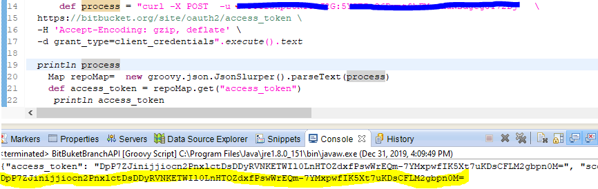

I am writing a CURL in groovy script to fetch the branches in a repository, the initials URL ( access token is working but the second URL to fetch the branches for repo is not working .
1st CURL to get the access token :

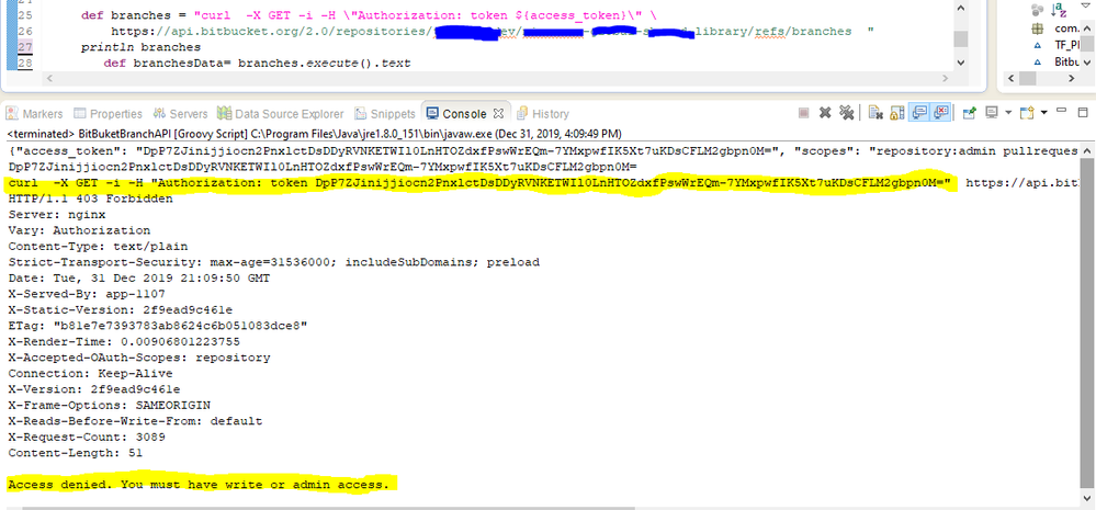

When i use the access token and execute the second URL , its says "Access denied. You must have write or admin access".
Can you please let me know, how to solve the issue. Thanks in Advance

I'm assuming that you pasted the access token correctly and that the URL you're using is the correct one. To confirm this, you could use the same access token with a different URL and check the results. You could also let us know the URL you're using so we can check if it's right.
I can see in your screenshot that you have changed the  Authorization: Bearer {access_token} for  Authorization: token {access_token}.Can you change it back to Bearer as recommended in our documentation and let us know if it works?
For troubleshooting purposes, if after having tried the above you're still having issues, you could try to use a different request, as per the documentation at Oauth on Bitbucket Cloud
  1. Send it in a request header: Authorization: Bearer {access_token}
  2. Include it in a (application/x-www-form-urlencoded) POST body as access_token={access_token}
  3. Put in the query string of a non-POST: ?access_token={access_token}
