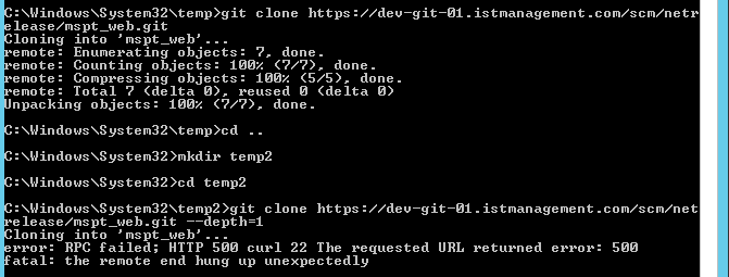

Hi, I'm trying to clone git repository using --depth 1 parameter using https, but I'm getting internal server error when this parameter is used. Does anyone know how to overcome this issue? I've already tried to set git buffers and compression and so on, but nothing helps.
full error response:
error: RPC failed; HTTP 500 curl 22 The requested URL returned error: 500 Internal Server Error fatal: The remote end hung up unexpectedly

Serina Joyce January 23, 2019
I am also facing this error.  I have an older repository with two commits on the master branch, i have already increased the buffer size.  I can reliably reproduce from command line as well.
