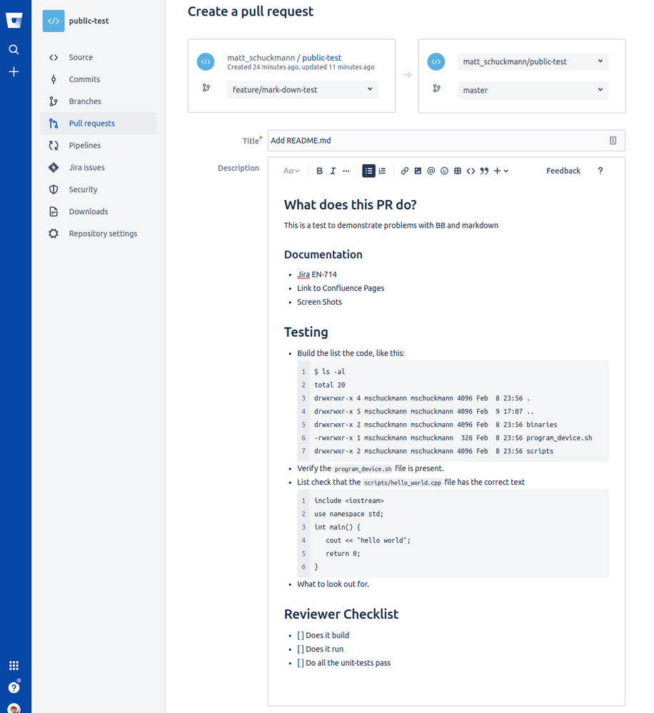

I'm finding that can't get markdown (or even formatting using the toolbar) to work as expected.
I most often see this when writing a PR description and the problems are usually centered around code blocks and unordered lists:
For example here is what wrote in a recent PR description:
Here is what I get after I click Update Pull Request:

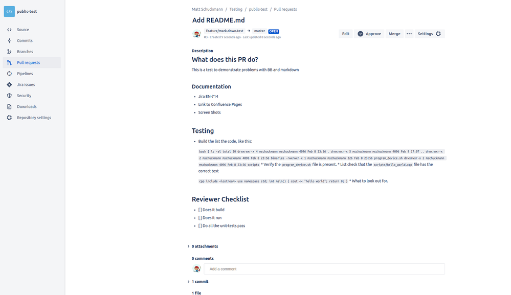

And this is a mild example, quit often all the bullet items have been concatenated on the same line and the code blocks look like long inline blocks instead of a solid block.

Since I couldn't create the PR in an Incognito tab, I went ahead and did it in a regular tab and then viewed the saved PR in an incognito tab.
Here is what the PR description looked like before I clicked Create Pull Request
And Here is what it looks like after click Create Pull Request (and it looks the same with in Chrome and Firefox in either regular mode or incognito.
You can view the PR at:
https://bitbucket.org/matt_schuckmann/public-test/pull-requests/3/add-readmemd
And here is a gist of the exact markdown that I pasted into the PR description:
https://gist.github.com/mschuckmann/e3d90a4fed6c46b01173b9db8eef481c
