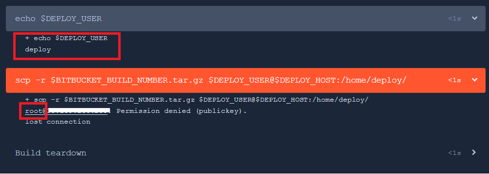

Hi,
I have a build pipeline which copies a tar.gz file at the end by using scp. I have added the SSH key of the user "deploy" to the settings, and the fingerprint of the server was added to the known_hosts.
I then created a deployment with a variable DEPLOY_USER with a value "deploy". This variable is populated correctly. The thing is, this setup works for a couple of times. After a while, I can't seem to pinpoint exactly when, the scp step fails. When this happens, I see the user root being used (which has no ssh access).
This happened on two of my pipelines in seperate projects, with seperate users.
I have added a screenshot to clarify the problem.

I've found a workaround.
Recreating the deployment variable isn't enough. I had to completely remove the Deployment (Settings > Deployments), recreate it and add the variables again.
I think the cause may have been a change in the IP-address of the server (scp destination). In both the projects where I had this problem, I changed the known_hosts and one of the deployment variables (DEPLOY_HOST). But I can't reproduce at the time
