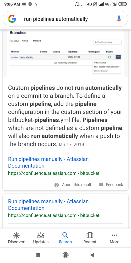

After testing for a while I got to make the automatic pipeline just by removing the "custom:" tag on my bitbucket-pipelines.yml file. Leaving it, in my case, as follows:
pipelines:
default:
- step:
Thank you so much anyway, cheers.

Plz find the documentation below, I hope u will understand.
https://confluence.atlassian.com/bitbucket/run-pipelines-manually-861242583.html
