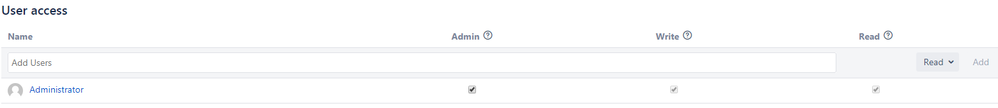

I believe 403 should point to an access level issue, but i've created this repo with the administrator account, making sure it had full privileges to the repo and that the git config information was correct.

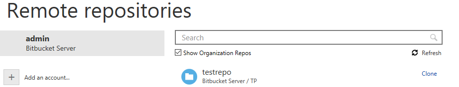

I've also tried to clone in sourcetree using the 'clone in sourcetree' link with the same results. The odd part is in sourcetree under 'remote repositories' I can see 'testrepo' on the repository list, i just cant clone from it...
sourcetreewtf.PNG.I'm not using SSH
